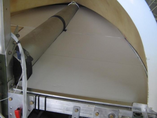

Brief Description:  cargo deck

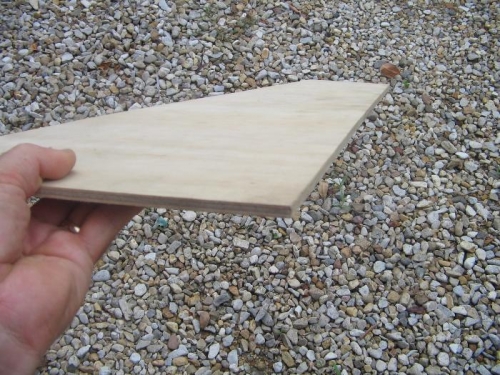

Made template from cardboard then cut out deck from 5mm flute board. Made baggage compartment cover from 8mm plywood for strength. When finished getting correct fitting I will glue another 5mm flute board on top of the other one although with the flutes crossed over for extra strength.
left hand side
left hand side

baggage compartment cover 8mm plywood
