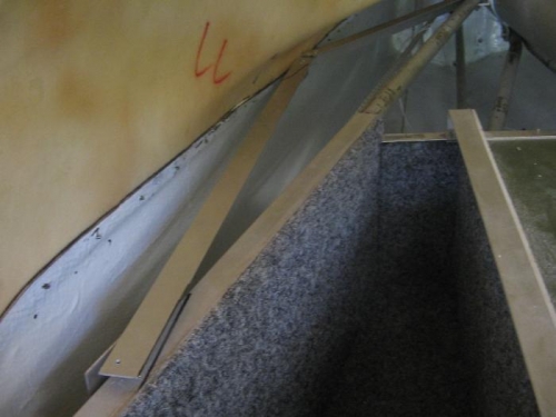

After experimenting with different thiicknesses I have decided to use 2 x 5mm flute board glued together as my cargo deck. To ensure that it is supported I am adding various aluminium angles to the frame and hull for support.

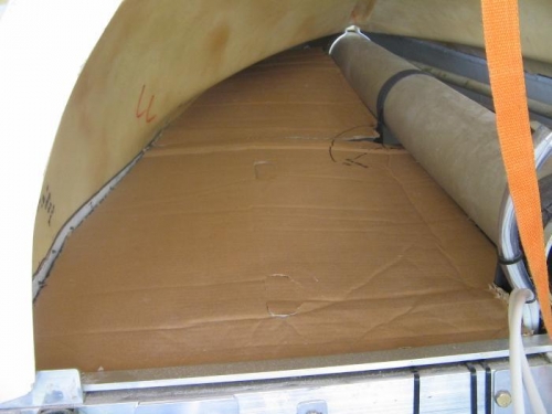

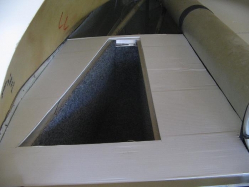

I found that making templates out of cardboard was the easiest method prior to cutting out the flute board. Once a template was finished the deck was cut out from 5mm flute board
cargo deck supports
cargo deck supports
cardboard template
cardboard template
baggage compartment cut out
