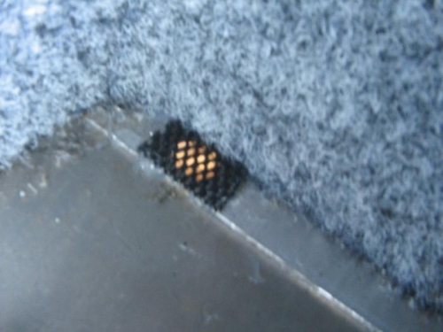

Drain hole baggage compartment
Drilled 12mm hole in underside of baggage compartment for water drainage and covered with stainless steel mesh to stop small objects falling through. Sealed alloy angle lip with silicone sealer to stop water accumulating between the overlap.
drain hole
