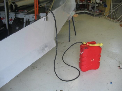

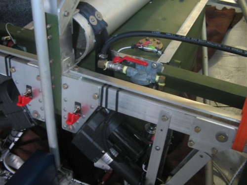

Before securing the frame into the hull I wanted to make sure that there were no leaks in the fuel system. Siphoned approx 20 litres of unleaded into the tank and connected the fuel pump wires to pump it through the system and back into the fuel can. While pumping the fuel shut off valve was partially closed to increase the pressure. No leaks were detected.
hose connected to top outlet feed to engine
back into fuel can
back into fuel can
