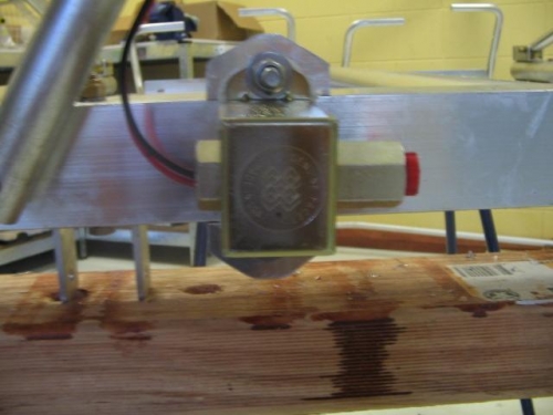

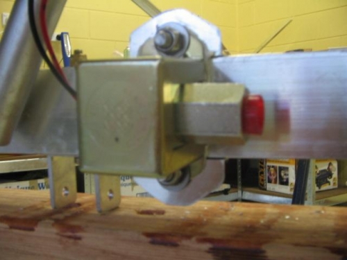

Made mounting bracket for electric fuel pump. Located it in a position below the fuel tank to gravity feed the pump. Lined rear of pump with hi density foam backing for reduction of vibration and no metal to metal contact

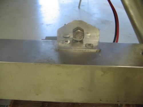

upper bracket for fuel pump
fuel pump mounted in position
