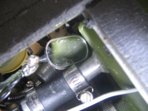

Found small leak in top left hand corner of fuel tank due to a pin hole in the weld during manufacture. Repaired with special 2 part epoxy supplied by tank manufacturer. After repair tested OK by spraying fuel onto the repaired area from the inside. Filled tank and checked again for leals and checked OK.
pin hole leak in weld
