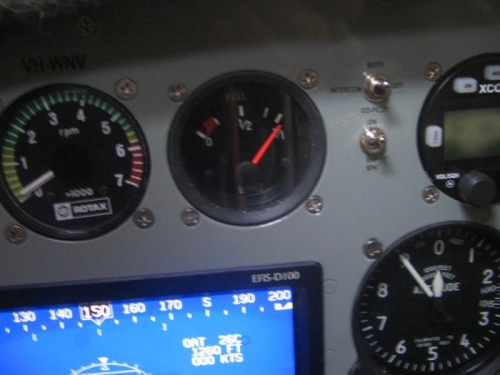

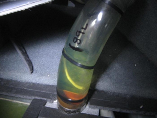

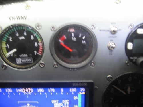

Calibrated the fuel tank/gauge. Results
flight ground
1/4 20 23
1/2 36 38
3/4 50 53
Full 59 63
