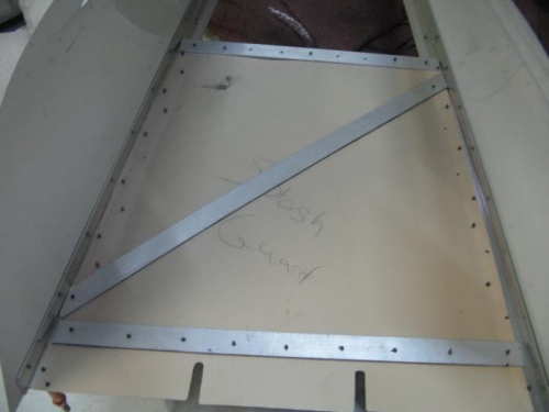

Brief Description:  boom tube cover

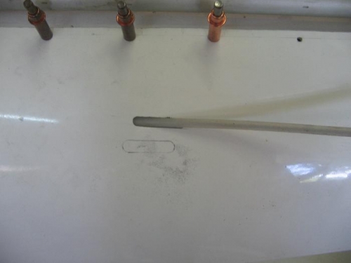

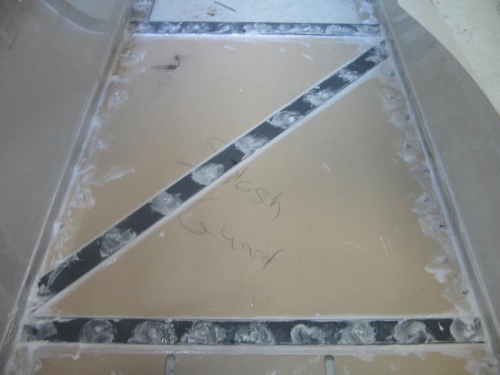

Cut slots for rudder cables. The whole cover seems too flimsy so I decided to add some support straps for strength.. Once fitted I sealed all rivets and gaps with silicone sealer as this area gets lots of water submersion and I didn't want it to get trapped.
Made sure that there was plenty of gap between front of splash guard and transom to allow flex.
rudder cable slots
rudder cable slots
support straps fitted
sealed
sealed
