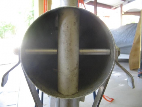

crush tubes in rear of boom tube
Fitted crush tubes to rear of boom tube on bolt that holds tailwheel strapping to boom tube so that bolt can be properly torqued to stop tailwheel movement.
crush tubes fitted to bolt
