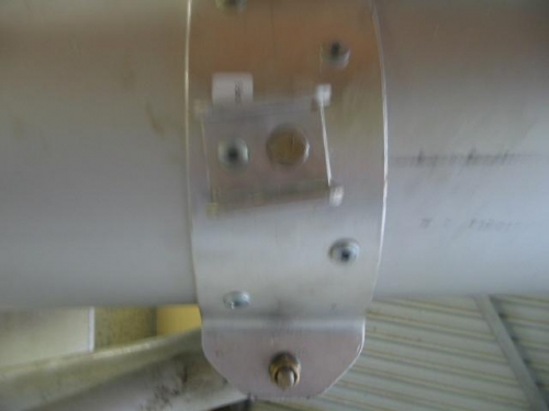

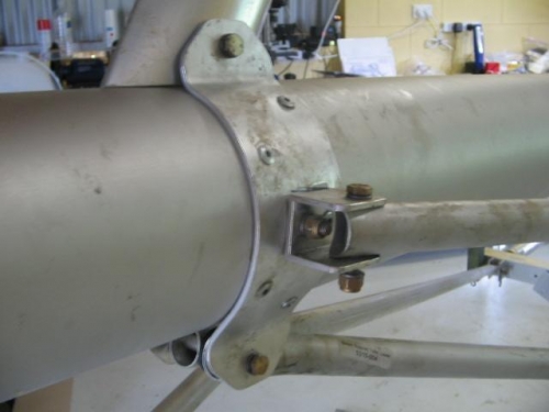

Final attachment of upper and lower boom support tubes to boom. Used extra SB6-8 stainless rivets to attach cluster bracket to boom tube plus extra rivet for positioning upper support tube channel bracket at correct angle.
used stainless rivet to stop movement of channel bracket
with boom tube in place
