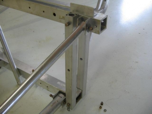

Brief Description:  upright mod
Fitted square tube alloy sleeves to left hand bulkhead upright tubes for extra strength as designed by Paul Williams. Coated with aviation grade etch primer. Also replaced AN24a and AN25a with AN30a bolts as per Searey Australia instructions for seat belt anchors
left hand uprights
left hand uprights
