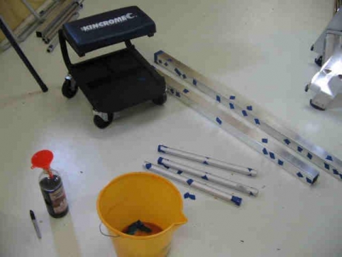

Brief Description:  Corrosion proofing tubes
Taped up holes with blue masking tape and coated with boiled Linseed oil part #’s 5310-002 Bulkhead cross tube, upper / 5310-003 Bulkhead cross tube, lower / 5310-006 Bulkhead upright tubes x 4 / 5310-015 Bulkhead diagonal tube x 2 plus elevator and rudder tubes
linseed oil through tubes
