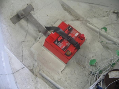

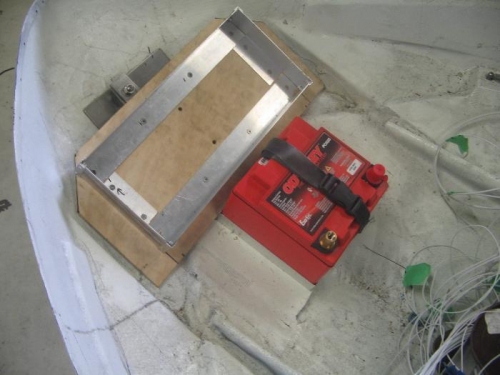

Mounted 925 Odyssey battery with 25mm x 25mm angle and strap. Made up bracket and mounting board for toolbox. Sides of board will be fibreglassed to hull.
Odyssey in place with toolbox bracket in place.
with toolbox mounting board in place

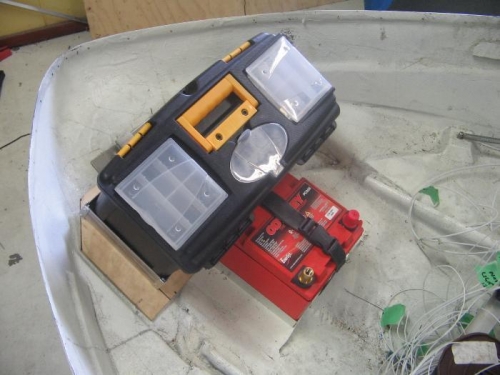

with toolbox in place.
