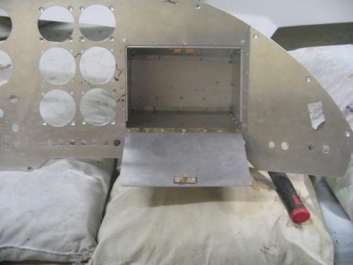

glove box compartment

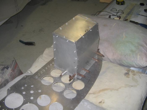

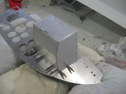

Constructed glove box compartment. Had to add slight angle down at rear of box to clear nose deck. Used solid rivets for attaching box brackets to panel and wait until the panel is painted before riveting box in place.
