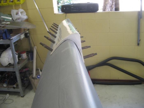

Brief Description:  Leading edge extensions
After final coat of Poly Spray was applied I trimmed and attached the leading edge extensions with Clecoes. Once correct position was determined they were removed and primed with a 2 pack primer. The next day they were sanded and attached with AL-44 ally rivets. Marine grade Sicaflex was used to seal edges and rivet holes.
