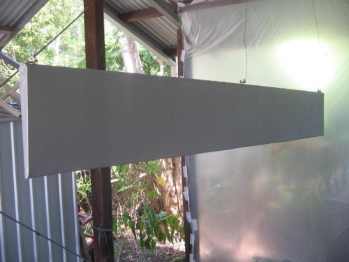

Brief Description:  Preparing control surfaces for topcoat
As the Poly Brush and Spray dries so quickly it was possible to paint them on work surfaces. As this is not possible with the slow drying topcoat the only way to paint them was suspending them by wire from the rafters.
All surfaces were scuffed over with a fine Scotchbrite pad before applying topcoat. Even though this is not a recommendation by Poly Fiber, I thought that it would make the surface a little smoother and add to it's adhesion.
flap suspended from rafters
