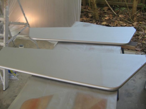

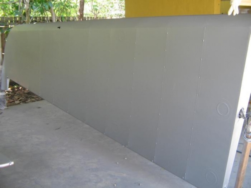

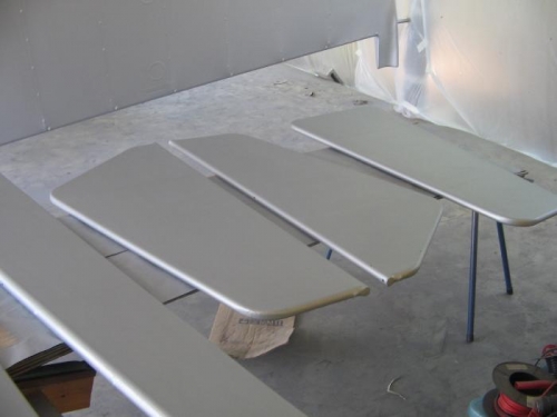

Sanded wings and control surfaces wet with 400 grit W&D. Checked over all pinked tapes again to ensure they are glued down OK. Applied final cross coat of Poly Spray. Looking good!
