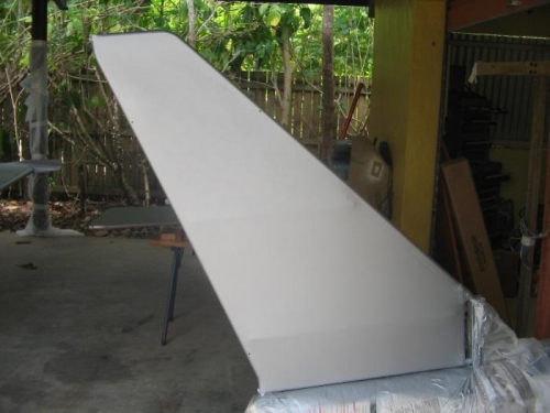

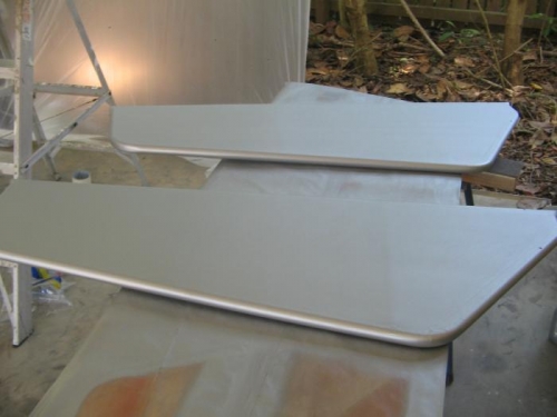

Brief Description:  Spraying Poly Spray
Sprayed two cross coats of Poly Spray to wings and control surfaces over 2 days. Used iron to iron down any pinked tapes that were lifting. Very few tapes needed ironing down and very few pinholes when applying the Poly Spray so very happy with result as I must have done all the Poly Brushing correctly.
Big job!
