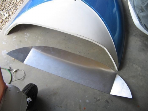

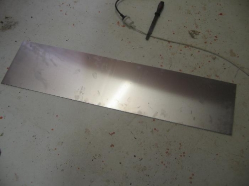

Made instrument panel from 2mm ally sheet 1200mm x 290mm. Had the local machine shop bend the sheet to the right angle then placed against nose deck, marked it and cut to shape with angle grinder. Finished off edges with file.
1200mm x 290mm ally sheet
angles added and cut to size
in place on nose deck
