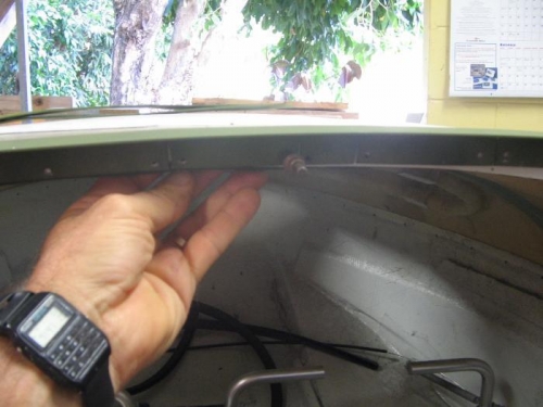

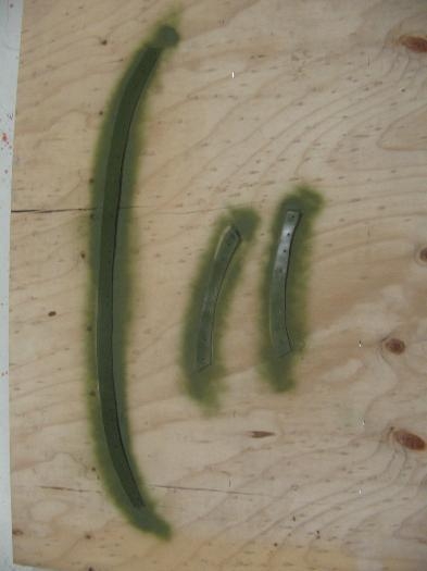

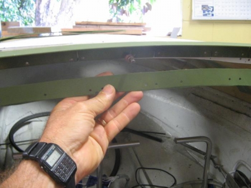

Made up a doubler for the brow as I didn't want to rivet the brow on to just fibreglass as I believe that vibration would cause the rivets to loosen up over time and also as I am using rivnuts to secure the panel to the nose deck I wanted the rivnuts to pull up against ally not fibreglass for similar reasons.
Painted both brow and doubler with zinc chromate.
doubler painted with zinc chromate
doubler before installation
doubler after installation
