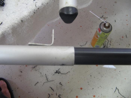

extra rib and bushes in elevators

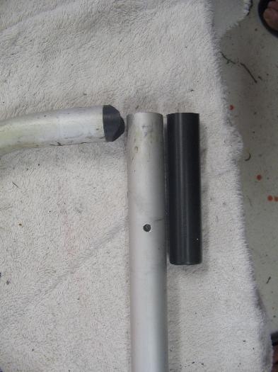

Added bushes to tube ends of elevators for anti crush and to seal tubes as not fitting drain grommets to rear control surfaces.. Extra long one fitted to bush elevator horn attach hole
nylon bush up to elevator horn attach hole
bush to leading edge attach point
