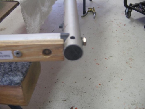

nylon bush inserts in stabs
Added nylon bushes to both stabs at all 3 tube ends for extra strength and to seal tubes as no drain grommets will be fitted.. Also added bush to where the stay wires bolt through the outer stab for extra strength.
before insertion
bush in place in stab trailing edge
bush in place in stab leading edge
