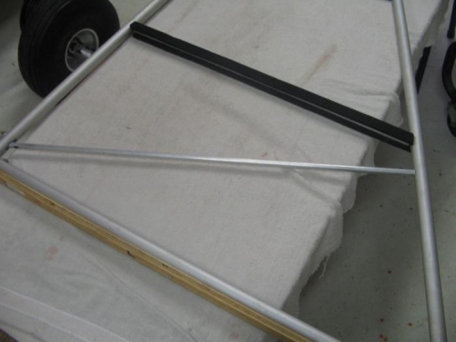

extra rib in stabiliser
Added a diagonal rib from hinge nutplate to leading edge in both stabs as this area gets punished on take-off on water.
extra rib in stabs

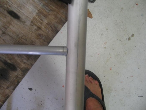

marine sicaflex used to bush and hold rib in place over hinge nutplate
rib shaped to inner leading edge
