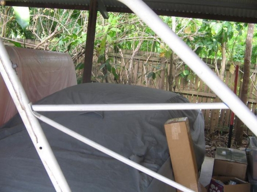

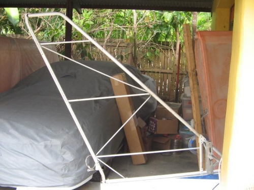

trusses in vertical fin
Added a truss and extra ribs to vertical fin to keep the edges straight when covering and to add some overall strength as the fin takes a lot of hammering from the prop.
trusses and ribs in place
front of rib shaped to curve of leading edge
rib shaped
