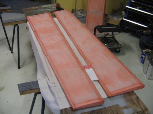

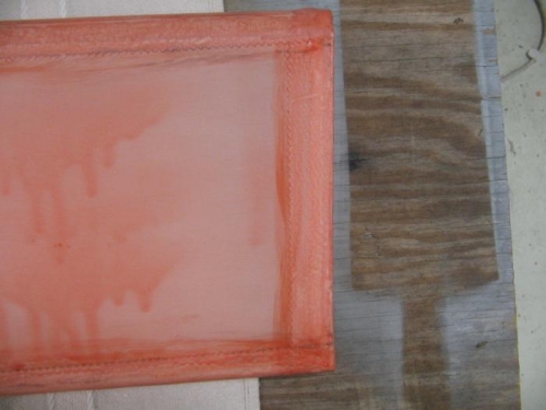

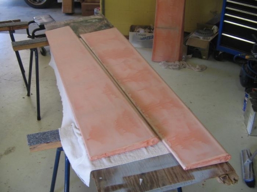

Brushed the 1st coat of Poly-Brush on both ailerons. I thought it would be quicker if I did both ailerons at once. Once dried 2" finishing tape was applied to ends and trailing edge then 3" tape to leading edge.
1st coat Poly-Brush
finishing tape applied
