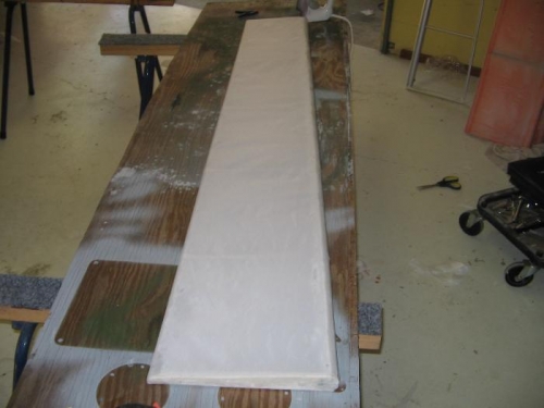

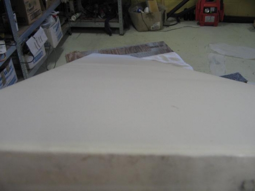

Applied fabric tape to sharp edges of aileron and glued fabric to leading edge. Wrapped the fabric around the trailing edge and back to the leading edge and glued. Glued down fabric on end caps and ironed fabric to tightness. Looks good.
prior to ironing
after ironing
after ironing
