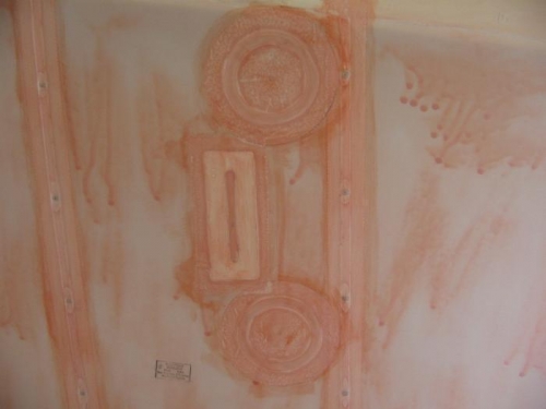

doilys over inspection cover rings
Glued doilys over inspection rings with Poly-Brush and ironed down at 250`.

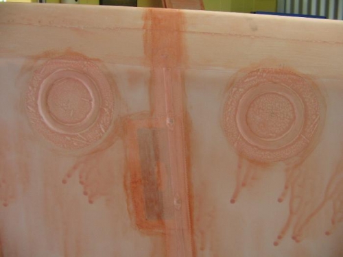

aileron horn access plate
extra ring on right for pitot access

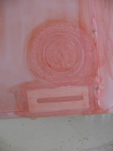

strut attach plate access
