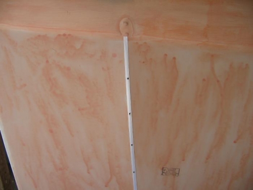

Applied sticky backed reinforcment tape to upper and lower ribs, burnt holes through with tip of soldering iron and Poly Brushed over the top. Riveted down with AL42 rivets.
