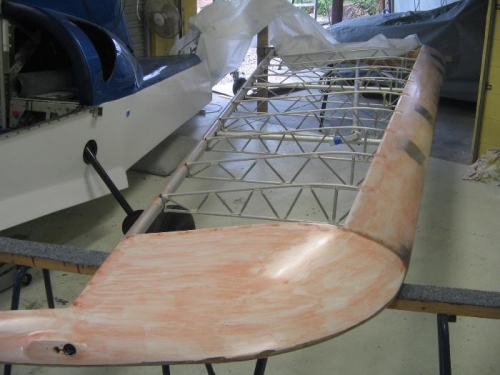

Poly brushing wing before covering

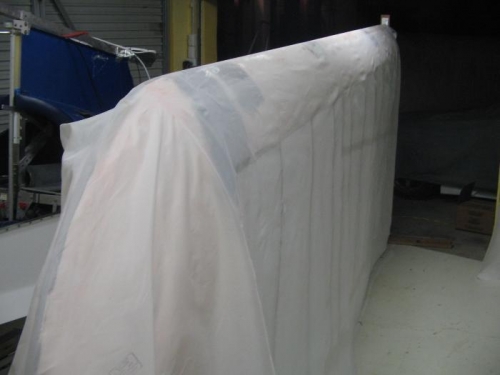

Brushed a coat of Poly Brush over wingtip, leading & trailing edges and also a coat on each rib to help adhesion. Glued fabric to upper side leading edge.
poly brushed wing
attached fabric to the upper side first
