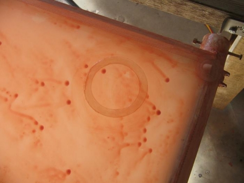

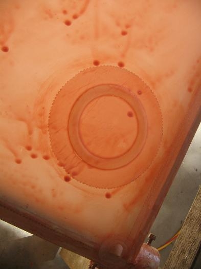

Brief Description:  extra inspection cover ring
I decided to add and extra inspection ring at the wing rib just above the trailing edge for access to the most inboard flap hinge. Although I have strengthened this hinge by adding doublers and it shouldn't wear out for a long time, it will have to get replaced at some point which would be impossible without access to the diagonal wire that attcahed to the hinge bolt.
inspection ring
inspection ring
inspection ring with doily.
