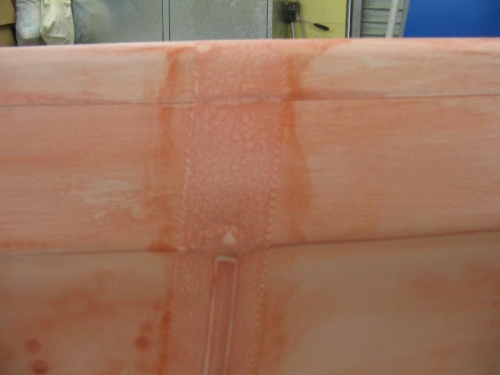

Date:  6-10-2009
Number of Hours:  3.00
Manual Reference:  Poly Fiber
Brief Description:  2" tape over ribs starboard wing
Applied 2" poly tape with Poly Brush over each rib starting top of leading edge and wrapping around entire wing finishing at top of leading edge. Applied another coat of Poly Brush over each tape. Once dried each tape was ironed at 250F especially around rivets for a better finish and to help adhesion.
2" tape over ribs
