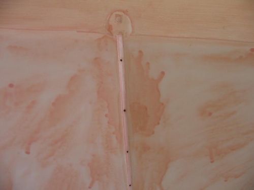

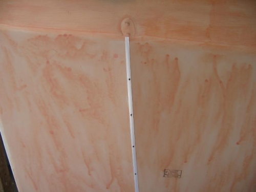

reinforcement tape starboard wing
Applied sticky backed reinforcment tape to upper and lower ribs, burnt holes through with tip of soldering iron and Poly Brushed over the top.
reinforcement tape
Poly brushed
