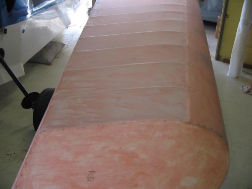

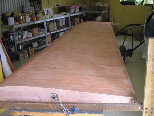

applying Poly Brush to starboard wing
Applied 1 wet coat of Poly Brush to upper and lower fabric then ironed wingtip, leading and trailing edges for better adhesion at 250F
1st coat Poly Brush
