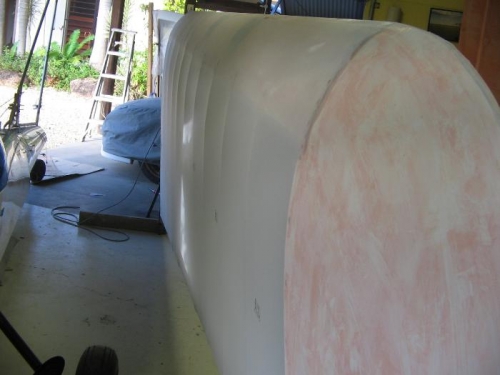

ironing starboard wing
Ironed the fabric at 250F then 350F. Started ijn the middle bottom then middle top then wingtip bottom then wingtip top then rib end bottom then rib end top etc.
bottom of wing
top of wing
