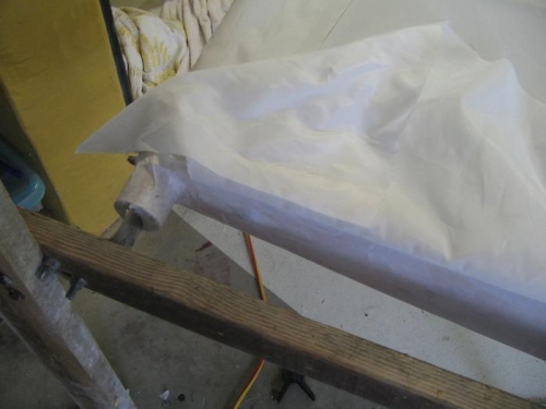

covering starboard wing
Glued fabric to top of wing with 2 inch overlap on leading edge. Glued entire rib with fabric. Ironed glued areas with 225 degree iron to smooth our wrinkles etc.
top fabric

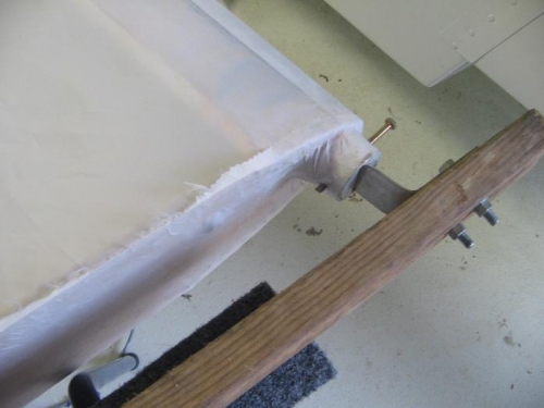

end rib
end rib
