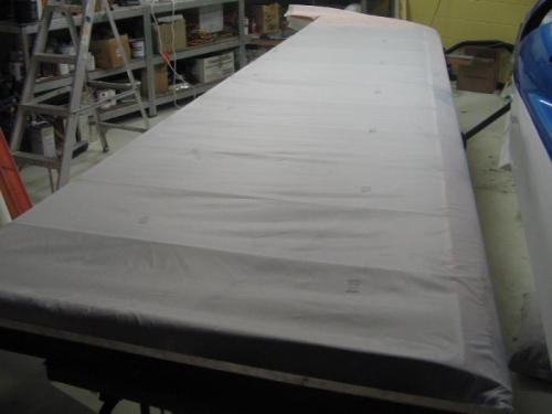

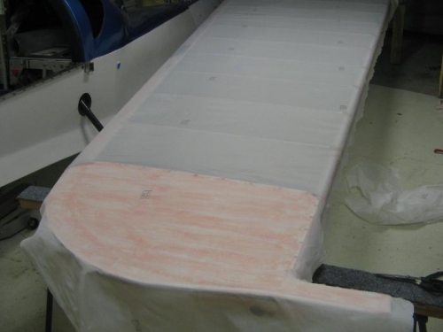

Poly brushed leading edge, trailing edge and wingtip for better adhesion. Glued fabric to bottom of wing first starting at leading edge and then trailing edge. Glued fabric to entire underneath of wingtip. Got it on quite smoothly without many wrinkles.
poly brushed
poly brushed

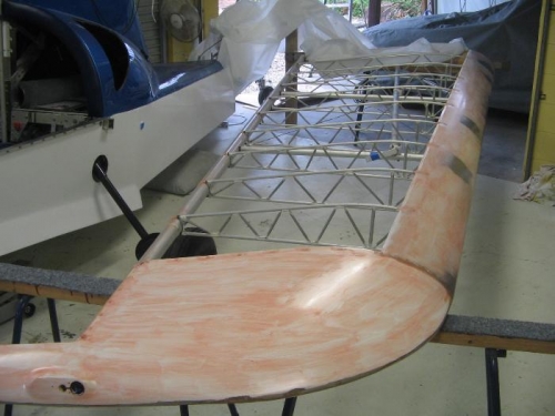

bottom of wingtip cove
rib end
rib end
