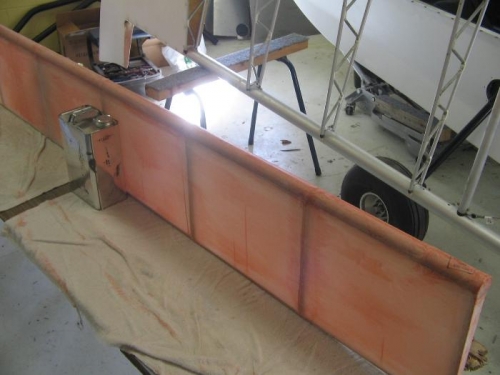

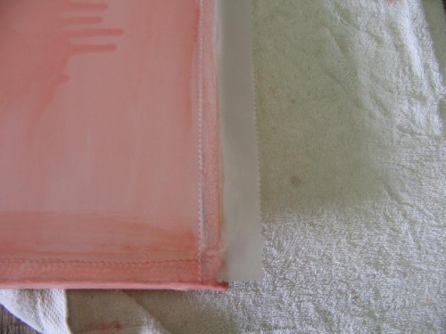

Glued finishing tape on edges with poly brush mixed 3:1. Glued 2" tape on end caps first then 3" tape on leading edge and 2" tape on trailing edge.
finishing tape on leading edge
finishing tape on end caps
finishing tape on trailing edge
