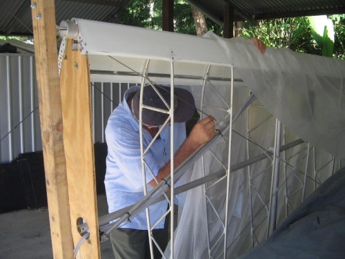

Brief Description:  Inspection by Paul Williams
Paul Williams fellow Searey bulider came around and inspected my wings prior to fabric covering. Suggested securing wiring harnesses a little better in each wing as subject to vibration. I agreed and will apply tape to harnesses at diagonal tube position.
Paul Williams inspecting wings before commencing covering
