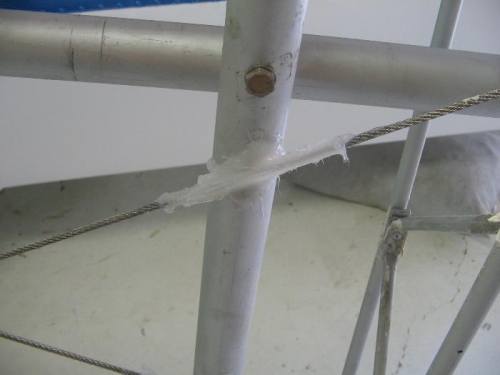

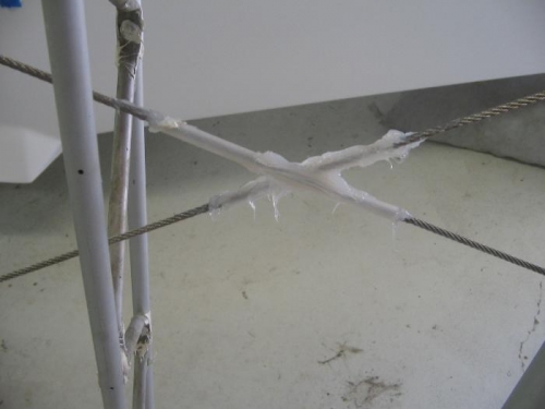

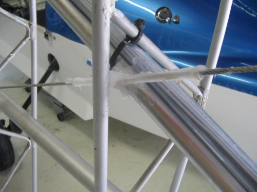

Cut and positioned the nylon wear tubes on internal wing support wires where rubbing could occur on compression tubes and wiring etc and siliconed them in position.
