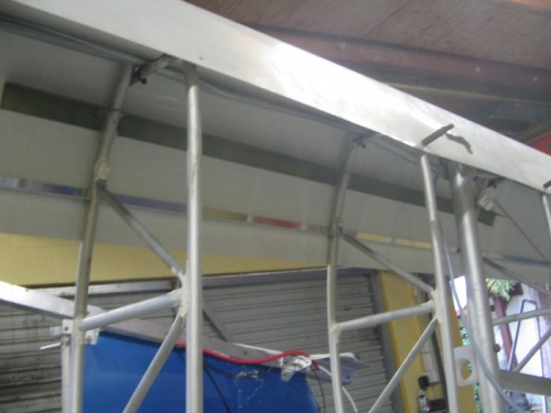

starboard wing support angle
Fitted support angle to prevent oil canning of the wing cuff over time as per Rob's instructions. Decided not to rivet in place so used silicone instead.
cuff support angle
