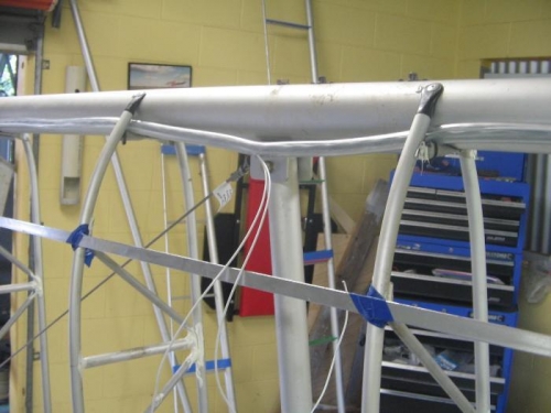

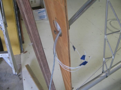

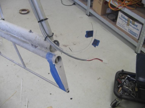

Ran wiring for strobe/nav/position/landing lights under leading edge through rib supports, down the diagonal and through the inboard rib. Encased the wiring in clear PVC tube and cable tied it on.
landing liht wires
strobe/nav/pos light wiring
inboard wiring
