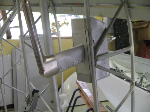

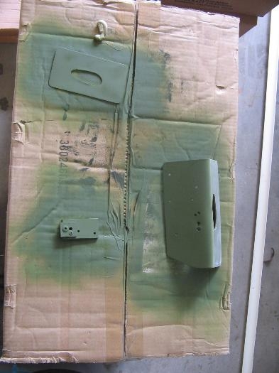

Brief Description:  pitot tube mounting bracket
Made up mounting bracket for pitot. Ensured that the pitot has enough adjustment to position it directly into airflow on first test flight. Will install cover plate once position has been determined. Primed with zinc chromate except bottom section where fabric will be attached.
pitot mounting bracket
pitot tube in position
brackets primed with zinc chromate
