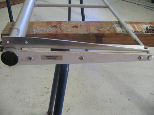

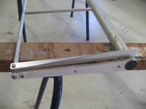

aileron horn brackets
Drilled 3/16"holes through leading & trailing edges 28mm in tfrom the end and test bolted on horn brackets. Had to slot the holes in the trailing edge end of both ailerons due to the compression tube being slightly smaller
starboard aileron
port aileron
