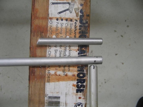

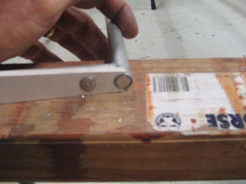

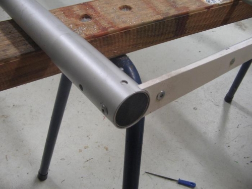

bushing flap leading/trailing edges & horn bracket
Added nylon bushes to inside leading edges and solid alloy bushes to trailing edges of both flaps.
Also drilled 3/16" holes in leading and trailing edges 28mm in from the ends on both flaps for mounting of flap horn brackets
nylon bush in leading edge tube
100mm solid alloy rod
rod inserted in trailing edge tube.
