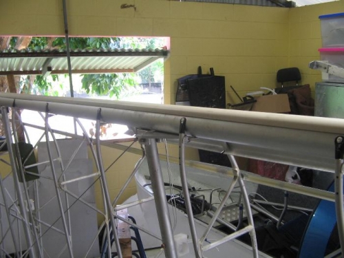

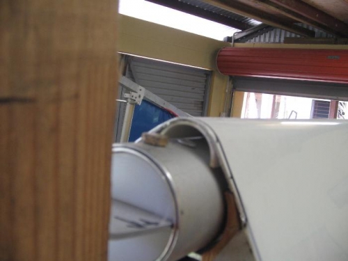

Cut 1" PVC pipe in half and fitted one half to leading edge of port wing for 2 reasons...
1. to stop bolt ends protruding through the leading edge and putting dents in the cuff
2. for extra strength in case of a birdstrike or hangar rash
