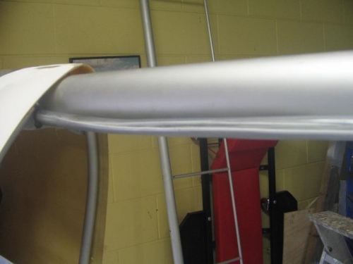

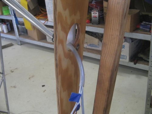

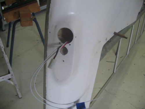

Ran wiring for strobe/nav/position/landing lights under leading edge through rib supports, down the diagonal and through the inboard rib. Encased the wiring in clear PVC tube and cable tied it on.
wiring harness inboard
wiring harness fed through rib suports
harness through wingtip
