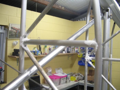

fitting starboard wing trusses

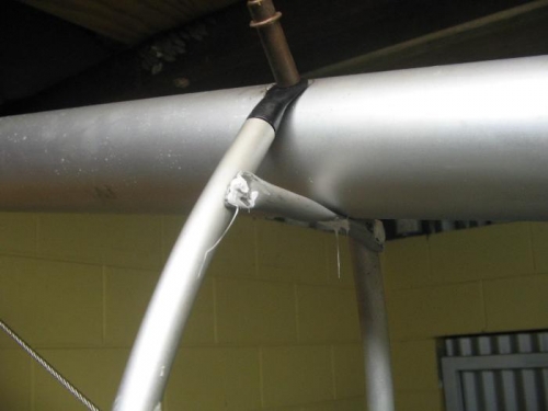

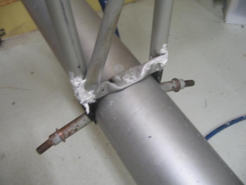

Fitted first 3 trusses to starboard wing. Filed top rib end of compression tubes to wrap around rib instead of flat on round surface. Used marine Sicaflex under all attach points and ardrox on all rivets.
truss #2
trailing edge rib support bracket
leading edge rib support bracket
