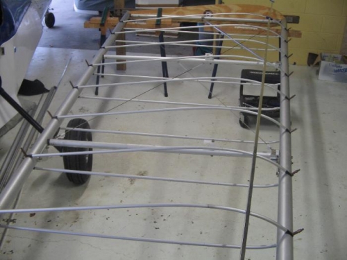

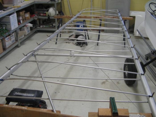

Brief Description:  RH wing ribs
Attached top and bottom ribs plus cuff angle. Made sure to attach them so that upper and lower ribs are vertically inline. Attached cuff angle 125mm back from rear of leading edge and marked position of compression tube 10" back from rear of leading edge.
top ribs
top ribs
top & bottom ribs
top & bottom ribs
cuff angle fitted
cuff angle fitted
