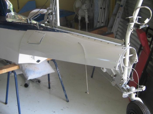

Fitting boom tube cover
Fitted boom tube cover. Used silicone sealer on all rivet holes and Ardrox on all rivets to seal lap joint from water. Touched up all rivets with paint.
LH side
RH side
