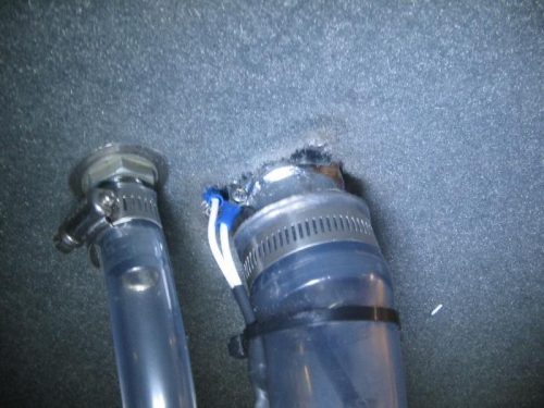

filler neck earth
Attached outer earth attach point to filler inlet and attached earth bond wire to filler neck on inside.
bonding wires attached to exterior earth attach point and filler neck earth point then to fuel tank
